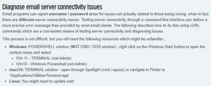

But running a cmd file containing the command , it still fails.
The instruction for the using cURL clearly state that PowerShell should be used
So confirm using POWERSHELL you no longer see a Login Failure?
