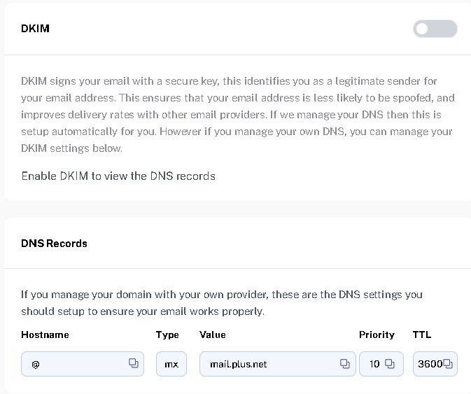

I see in the Greenby settings the following and I am wondering under what circumstances I might turn on DKIM and use the suggested DNS setting.

Thank you @MisterW I take it there will come a time when settings will need to be updated. When that happens will I need to add the DKIM record to my domain's DNS?

@MisterW I think I may have slipped up with my explanation. When I send email in Thunderbird, I use the username and password of my Plusnet/Greenby account together with the relay.plus.net server. I just put my domain's email in the Email Address box under the Default Identity section (I think this basically means it shows that address in the From field). I am assuming that this would cause a mismatch. Plusnet didn't allow any DKIM records but Greenby seem to provide a DKIM key. Apologies if I'm not making much sense. I'm not technical.
Yes they do provide one but I fail to see how it will work. A message must be DKIM signed by the domain in the FROM field. If Greenby doesnt actually host your domain then it wont know how to sign for that domain.
I could be wrong, but I dont understand what the point of the DKIM key is that Greenby provide in the portal.

Ah OK. so should I enable the DKIM key within my domain's settings at Fasthosts or does this still not work?

ICBW but I don't think that will work. The key in your domain DNS ( I assume at Fasthosts) is the public key to be used by a receiving server to check the DKIM signature in your email. AFAICS the Greenby servers wont DKIM sign any outgoing mail for your domain because they dont host it. All that will happen if you add the key to your domain DNS is that receivers of your email will try and check for a DKIM signature, find there isnt one and detect a DKIM failure.
