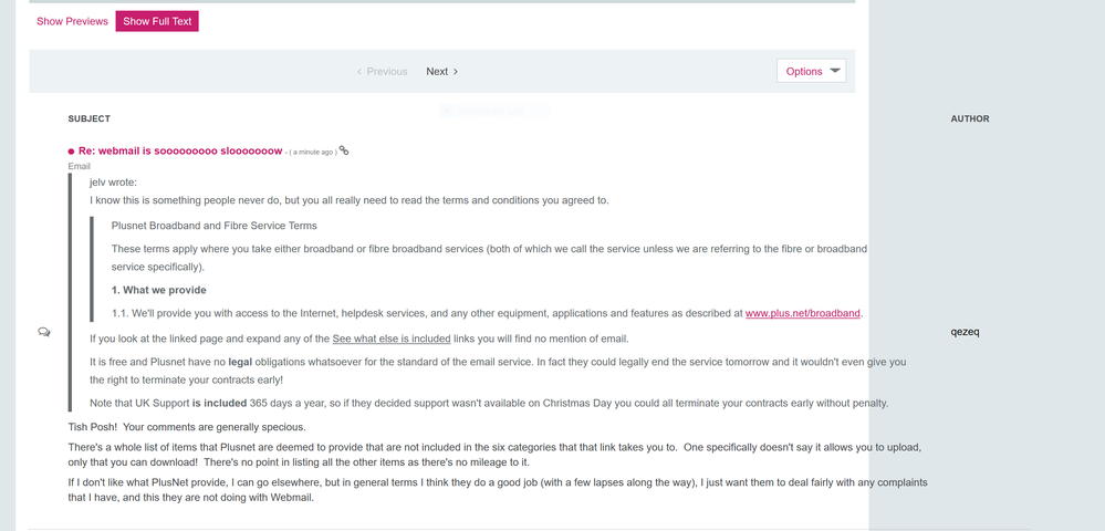

I'm seeing this when it wasn't there the last time I viewed the site about 45 mins ago! Any thoughts?
Oops!
This is with all thread not just the one shown using this URL:
https://community.plus.net/t5/forums/unreadpostspage/tab/message:full

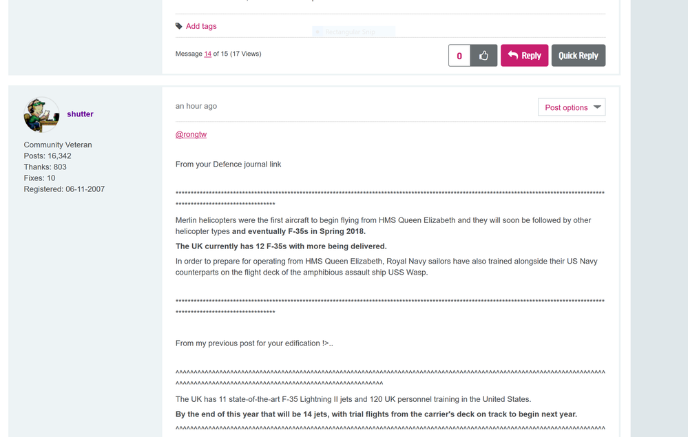

If I view the thread directly this is how it shows
It's only broken when using the link in post #1

It's not peculiar to that thread either as this shows
