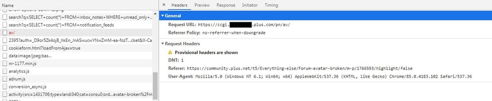

My avatar is dead. It's hosted on the plusnet hosting service and yet when visiting the image url directly, it works perfectly.
I can only assume that the 3rd party supplier has decided to block hotlinking as when refreshing the forum page and looking at the http headers, my forum avatar is requested but gets no response at all - the server just seems to close the connection.

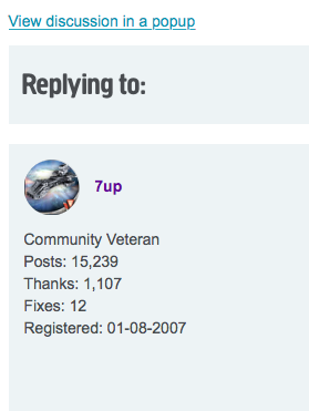

Seems to be working for me @7up though I am using my Mac Mini.
Screenshot attached.
EDIT: I notice it changes each time I refresh a page, are you using some kind of script or does Lithium support different Avatars (like they do the spell checker - laugh).
EDIT 2: Trying to get in before this clandestine 15 minute edit limit, refreshing the page I get this and this:
Screen Shot 2020-09-19 at 7.15.47 pm.pngScreen Shot 2020-09-19 at 7.16.06 pm.png

That's interesting that it's showing up for you but not me. My browser doesn't even get a reply in the http headers.
Yes there is a php script in use to provide random avatars (i get bored easily lol). My current theme is stargate but i also have Knight Rider and British Rail too. Plus a general theme which just picks anything at random.

This is the http headers from my browser - note that there is no reply at all from the server unlike all the other requests you see on the left (including those that let you run your own SQL DATABASE CODE on the forum server... oops... how did plusnet allow that?

Well this has turned out to be a chrome update gotcha. It's decided that because the plusnet forum is https, my avatar must be too - even though the forum html source clearly provides an img src of "http://". The plusnet hosting my avatar is on doesn't support https - only http.
So google has basically dictated that they're going to break the look of a lot of the internet by assuming they can just switch to https for every image a page specifies in the html.
Confirmed it with chromes DevTools. I get error about a ssl cipher mismatch - which will obviously happen when a server doesn't support https.
Thanks for breaking the internet, love you too google!!!
