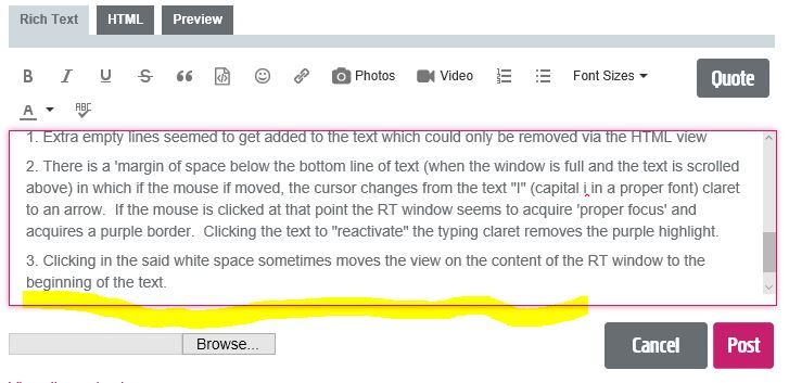

@jaread83, Hi Jack, As per screen grab purple boarder on RT box - NICE! However no name hint when typing @User ... may be Lithium broke something? ...hang on a minute - there's no RT controls here - cannot attach the image!!! Browser is Edge...!
Posts: 29,328
Thanks: 13,464
Fixes: 251
Re: Forum and Edge issues
Capture RT purple.JPG@jaread83,
OK am now in IE on Win10 - looks like Lithium have broken Edge support!
No purple boarder here, @user_name works here and RT controls are present - see attached image from attempting previous post...
Also on Edge, I got that jumping to top of page problem when clicking the post-options drop down ... which was fixed a long time back!
Also on here (IE) attaching that image placed it at the top of the post (not at the cursor) and over wrote part of the post.  Does no one have control over Lithium's QA?
