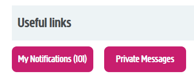

For a couple of weeks I’ve been seeing inconsistent new notification counts.  In the “space” of taking some down time, I’ve not looked at my notifications page for 2+ weeks.
Upon logging in I see 101 new notifications reported.

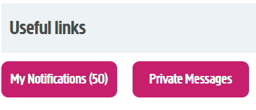

Subsequent to making a post, circa 50 notifications are then reported.

Notification Count on LoginNotification Count on Login
Notification Count after having made a postNotification Count after having made a post
