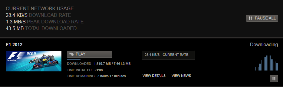

    Steam downloads - I tried to pre-load a game tonight and normally on Steam I get 7.0MBs (yep capital MB), tonight I was getting the screenshot attached.
