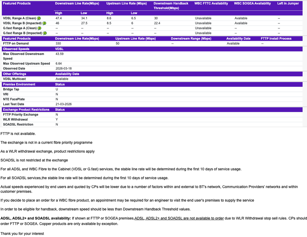

Can you share an image from the following after hiding your details. Include the narrative below the results window. This will tell us what your options are with PN.
As already stated you are free to move to anyone you want at the end of your contract.

Thanks for the information. It confirms you'd be moved to a SOGEA connection with speeds of between 47.4 & 27.5.
Full fibre isn't available. Have you checked OpenReach to see if they have any plans for your area.
You don't get cut off at the end of your contract - you simply get charged the non contract price (which isn't cheap). This might work untill such time as either the AltNet installs or the PSTN service is withdrawn. If the latter happens before the AltNet install then you've got problems.
