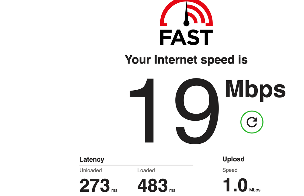

it has been the past week it has been like this. I was on the phone with Plusnet because the internet was so slow and thought this was the problem with the videos not loading. this is my speed test

Is the slow speed test recorded with your phone connected? If so, my suspicion is that your phone is backing up to iCloud at the same time. You can only use the bandwidth once.
