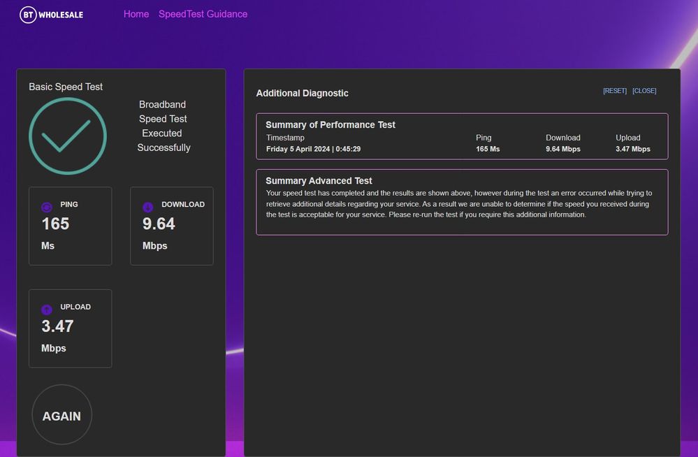

BTW Performance Tester - Over a wired (Ethernet) connection if at all possible, please report the 'ADDITIONAL DIAGNOSTICS'. This test is recommended to be performed with only one device connected.
For the Hub One -
For the Hub Two -

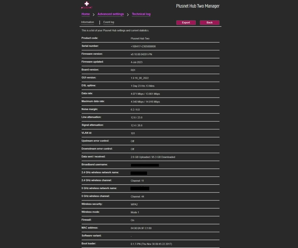

Screenshot_5-4-2024_04624_speedtest.btwholesale.com.jpegScreenshot_5-4-2024_03958_192.168.1.254.jpegScreenshot_5-4-2024_04430_192.168.1.254.jpeg

@saidalinneagoe  The data in the first of your Hubs Technical log shots is incomplete - what are your noise margins, please? Or you could just use the links provided by @Baldrick1 , which would save me bothering to try and help.

Can you re-do the above screenshot in such a way that the Plusnet banner doesn't obscure the info @jab1 needs.
You don't need to capture the entire page, just the section from "DSL uptime:" down to "Data sent / received:"

@saidalinneagoe Thanks for full information - makes life much easier. From the above, it appears you have a DSL drop around two days ago? What is the 'uptime' showing on your 'broadband - internet' tab please? and can you export your event log and attach it to a post,. Your noise margin looks OK, but your data rate figures tell a story - something has caused DLM to throttle your connection to achieve stability.
Your data transfer figures look very high, but I don't know when they get reset.
Sight of the Event Log may prove interesting.
