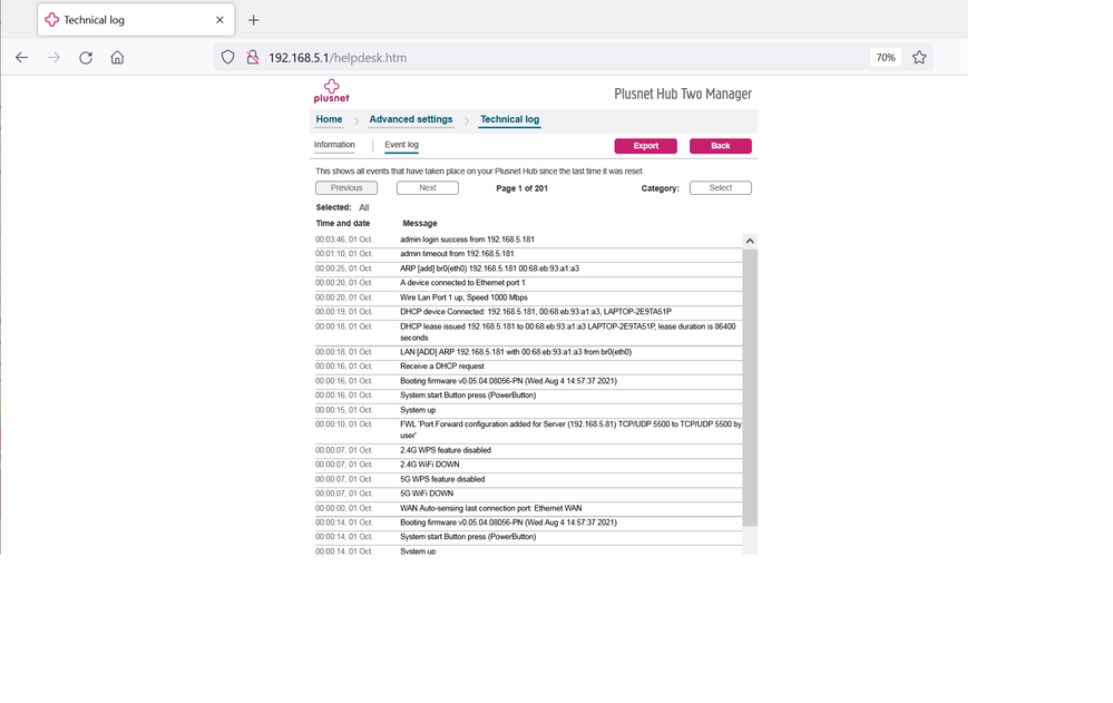

Thanks. The error log is accessed on this screen.

Re: VDSL connection drops every 5 minutes
Ah - you found it! Looking at the connection time on that snippet, I suggest you report a fault via: https://www.plus.net/help/report-a-problem/
