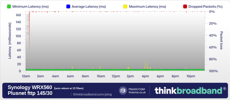

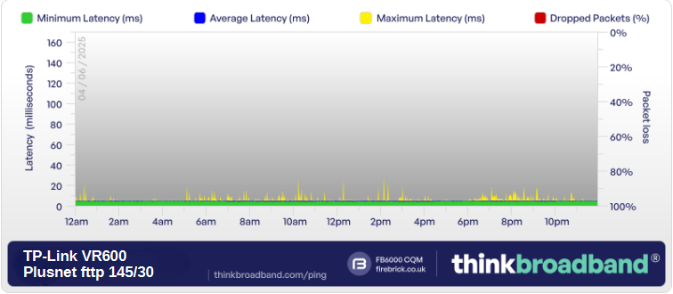

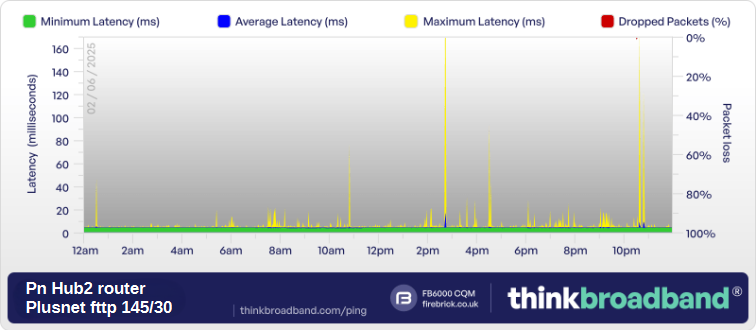

This might also be of interest re BQM data...
  When I set this up a few months back I tried out several different routers...  an old TP-link,  My PN Hub2 and the Synology WRX560 that I normally use.   It was quite interesting to see the different results simply based on the same network performance and the different routers...  My WRX560 graph shows regular failure to respond to the pings, we put this down to the router being busy doing more useful stuff and not bothering to reply to the pings, I also had to adjust the Denial Of Service settings to allow it to handle multiple frequent ICMP pings.
BQM 2025-05-31 WRX560 (s).pngBQM 2025-06-02 Pn Hub2 (s).pngBQM 2025-06-04 TP-Link VR600 (s).png
