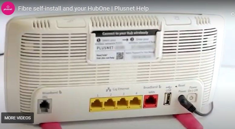

Posts: 5,016
Thanks: 3,317
Re: Switching Router for new contract
@bmc
The Hub One DOES have a WAN port
@saschavii
To use the Hub One it maybe necessary to factory reset prior connecting the WAN port to the ONT. As part of a first boot after a factory reset it auto detects a DSL or WAN port connection and enabled the required port as required.
If it is important to you the Hub Two 2.4 and 5GHz wireless name can not be split.

Posts: 20,453
Thanks: 9,286
Fixes: 585
Thanks @Dan_the_Van
Not only does the Hub 1 have a WAN port, its in addition to the 4 LAN ports whereas the Hub 2 uses port 4 , thus giving only 3 LAN ports.
Yes @MisterW the hub one does have a WAN and 4xLAN ports as per the video on the Plusnet support site...
Here's the link router-user-guides/hub-one
