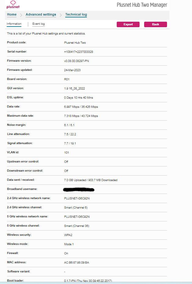

Here's the photos that you suggested, hope they help! Thanks. Bill.
Broadband availability checker.jpgSummary of Performance Test.jpgBTW Speedtest.jpgHub Two Manager Technical Log.jpg

Very strange, Bill. From that data, you do not appear to have any major issue. One final check. Can you connect the Hub to the test socket on your master socket (via a filter), and an ethernet cable from the Hub to your laptop?

@napolibill
It looks like over 10 hours you have uploaded 7GB of data. This might indicate that whilst you are trying to do a speed test you are uploading a load of data, which will absolutely kill your download speed.
Leave the computer alone for a few hours to see if it settles down. Alternatively if it’s a windows machine go in to the resource monitor and see what the computer is doing.

Very good spot @Baldrick1 . Must admit I didn't 'see' that, but it would explain a lot.

Well, well, well.  That uploading sneaked in under my radar!  I stopped the Google Drive upload and bang! back to 34Mbs download. Thanks very much Baldrick for helping me sort the problem out. Regards, Bill.
