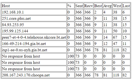

I also have a static IP address, using MTR I tested both servers. (My setup Hub Two in bridge mode TP-Link router)
74.91.125.204
208.167.243.170
So my response time for 74.91.125.204 is slightly longer, 208.167.243.170 is inline with yours.
