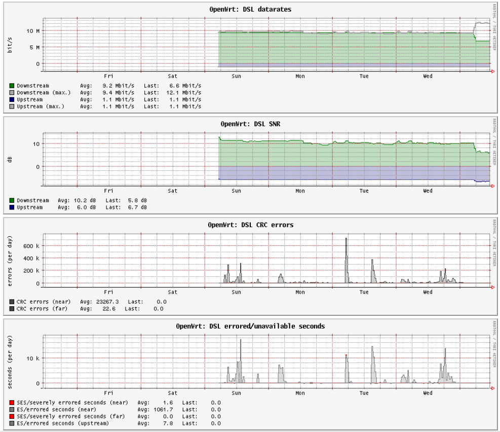

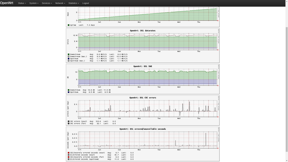

The last stats that I screen dumped prior to this problem is from the week up to 13 May 2022 - the end of the last issue: Shows 8.6Mbps@10.8dB (though it does show fewer errors).
And before this latest "intervention" I was running at almost 10mbps@10dB - I had noticed my line stats had been improving lately, I just figured it was because everyone was on fibre and my cabinet was empty (no FTTC in my cab)!! (not the 40dB Line attenuation... that never changes).
The line was in use until midnight at least, with no errors after 22:30.
I've been mad busy the last few days, and I did not collect all of the stats before power cycling the modem... but I did take a copy of the last 24 hours (it doesnt have the errored seconds though).

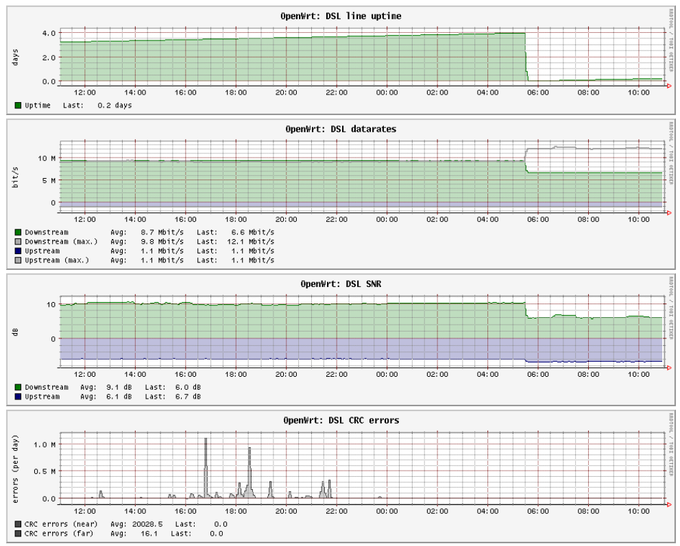

The 7 day data for this event in my previous post makes it look like the  the datarates and SNR drops were gradual (prolly something to do with averaging). But the 24 hour data (below) shows it to be a single event - I'm sure Plusnets stats will show it as a single event as well?
This shows the 4 days up time, then a drop and a Last Uptime of 0.2 days (or 4.8 hours). Sadly it does not record the number of resynchs but I'm certain I checked the live stats and saw only 1 loss of signal for the whole 4+ days.
The synch speed and SNR changes look more precise/singular here (ie 1 event).
It does show that I was synching right on the limit of my lines capacity at 10dB and it shows a lot of errors (relative to what I usually see) over the busy evening period... I'm now thinking this was my fault for not leaving enough headroom. I probably intended to keep a closer eye on it - but life happens!
The resynch (that I initiated) from 4 days before this graph was done with a -2.0 Target SNRM. This implies DLM was targeting 12dB... why would it jump straight to banding without targeting 15dB first?

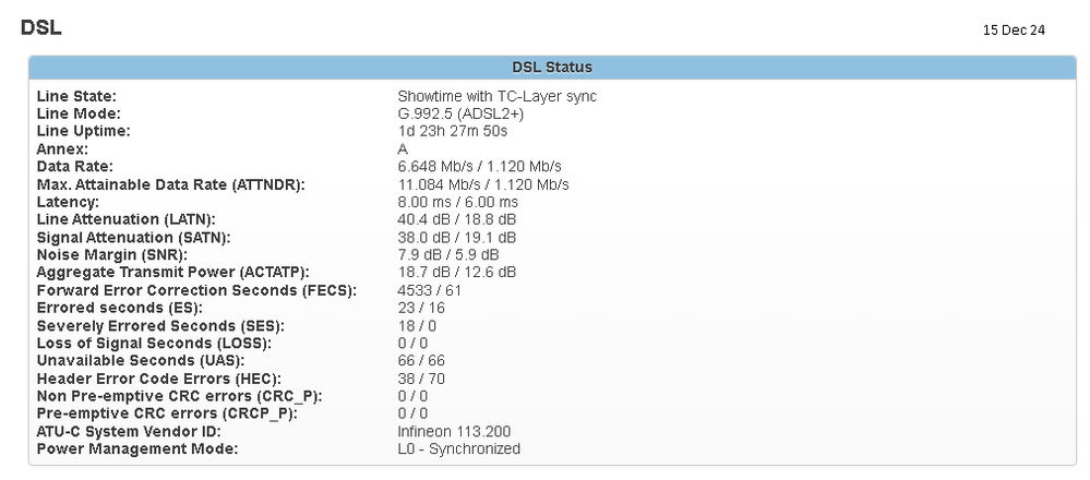

Data Rate 6.648/1.12 Mb/s
SNR 7.3/6.1dB
With these figures there is no way that a DLM reset to 6dB would improve your speed, especially if you then move the SNR to 10dB. So either:
This data was captured at a time of high noise on the line, or, your tinkering with SNR has got your router/DLM confused and is incorrectly reporting the true situation. Maybe if a reset solves the problem it is the latter?

Those live stats you quoted @Baldrick1 are from over 30+ hours after the mystery reset/banding.

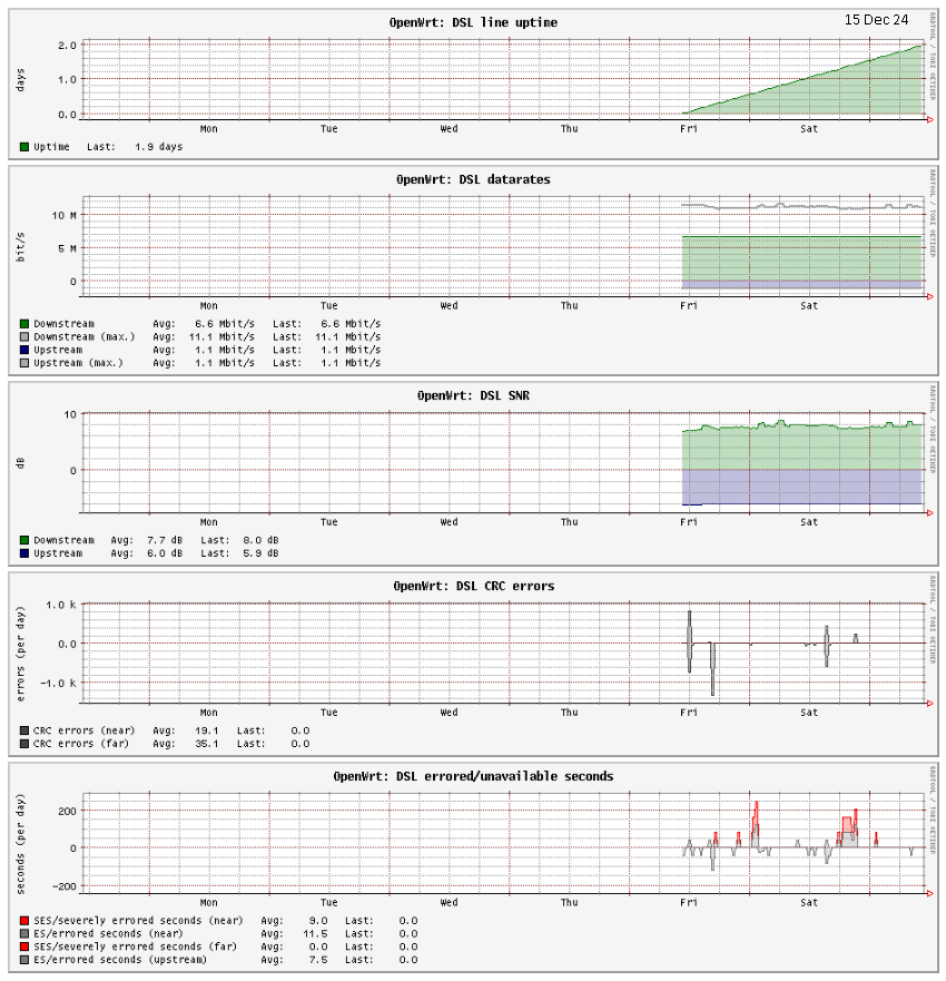

Perhaps interesting to someone is that my margin seems to be very gradually INCREASING (yes, increasing?!) since my last reset. This is since my power cycle:
15Dec2415Dec24
You can see I get a good few errored seconds with such low (8dB!!) SNRM even with the speed cap in place.
And if you wanted the latest live stats
15Dec2415Dec24

You can see on the graphs that the max line speed is higher than the current synch speed... the max line speed reflects the speed for the current SNRM... the very fact that the line has synched lower than the max speed indicates to me that a cap is in place (or the line was very noisy during negotiation; but since this has reset/renegotiated 3 times at the exact same speed I'm inclined to think that noise was not the limiting factor).
Doesn't routerstats require a PC to be running and regularly polling the modem? I don't currently leave PC's on over night so I wouldn't have caught this. Maybe routerstats can be run in OpenWRT?
What granularity is required? It's too late for this event, but the stats are all recorded at much lower granularity using rrdcollect or something like that I think. But the data files are all recorded in memory and I have not had the need for a process to collect and backup this data - but that is possible.
I did not collect the data prior to my last power cycle; I honestly thought (hoped) the power cycle would correct everything!!
Woulda shoulda coulda!

@Anywho wrote:
"a DLM reset to 6dB" - Hmmm... I think one of us is misunderstanding. It is probably my terminology.
What I want is for the banding (the cap, the newly applied DLM restriction... whatever) to be removed from my line..
I am certainly not misunderstanding.  A DLM reset removes any speed capping (if applied) and resets the TARGET SNRM to 6dB.
If this line was speed capped, you might see an elevated dynamic SNRM, as there would be a higher margin at the slower speed.  All the evidence offered points to a line fault.  Why not simply invoke the faults reporting options?  If no fault is found, THEN you have grounds for exploring other options.
If there is a fault, doing a DLM reset will most likely simply spin the merry-go-round yet again.
As for current stats, snap shots are not helpful, what is needed here is 10 second interval plotting of the current SNRM (and before and after sync speed in the event of a disconnection).  Views such as the below provide a valuable insight as to what is really happening on the line.  As you note there are spates of chronic errors ... a DLM reset will not fix that.
This 10 second** interval SNRM plot shows a line suffering chronic short burst** noise from 20:28 (what got switched on?) until 22:50 when it stopped abruptly (what got switched off).  Until you can see what (if anything similar) is happening on your line you are not going to FIX your issue.  The approach you have been taking appears to be little more than managing the symptoms at the margin.  It is probable that what ever is the issue here has degraded further and is no longer manageable by the same methods.
** A longer sample interval would be unlikely to discern the short burse noise issue.
Do the QLT test and then raise the appropriate fault report - VOICE if there is noise on the line - BROADBAND if there is not.
