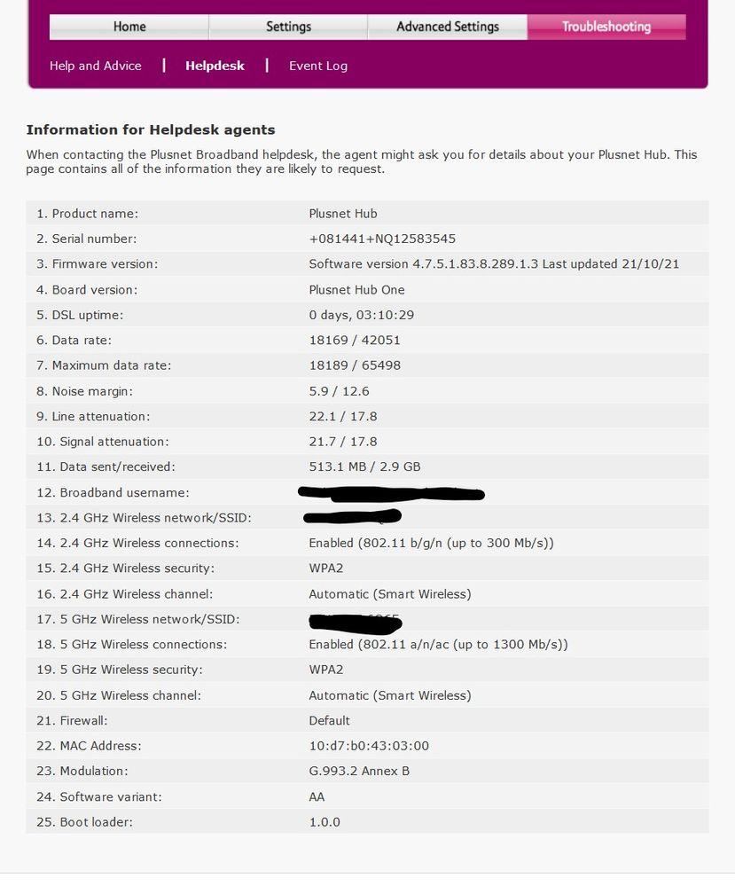

@NicDB If the automated system is obviously failing, maybe giving us the details requested below could enable other Community members to have proper look?
BT Broadband(obscuring your phone number) and BTW Performance Tester - Over a wired (ethernet) connection if at all possible, please report the 'ADDITIONAL DIAGNOSTICS', and sight of the broadband connection status from your Hub (with the 'Username' obscured) would be a good starting point.

Here are the screenshots as requested.  Tried the Quiet Line test but as our phones are cordless DECT phones it's a bit misleading and inconclusive.
BroadBand_Issues_2022-10-13 201809.jpgBroadBand_Issues_2022-10-13 201808.jpgBroadBand_Issues_2022-10-13 201807.jpg

@NicDB Thanks for that information. according to the Help Desk shot, your connection time is very low - have you intentionally disconnected your Hub about 3 hours ago? The Line and Signal attenuation figures suggest you should fairly easily be obtaining and and keeping the max data rate quoted.
I'd be interested in the engineers findings, so please post back when they've been.
