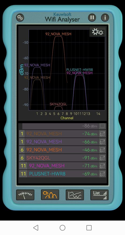

What's disappointing reading through this thread that no one asked the question on the Hub and mesh equipment being used and how it is setup or suggested to check how congested the 2.4 and 5GHz channels are. Perhaps the Huawei phone has difficulty connecting to a wireless signal on a very congested channel.
Installing a WiFi analyser app on the Huawei phone would be useful as it help show how strong a signal it is receiving, possible if connected to a 2.4 or 5GHz channel and if that channel is congested.

Max no of devices has been 15 but they're not always all connected. Plus net router, tenda mesh. Both run 2.4 and 5.
I get the same results whether connected direct to router or via the mesh and it doesn't matter if it's on 2.4 or 5. Slow connection direct, still slow but faster if I use a VPN. The phone has no issue connecting, it's not dropping off, it's just slow.

Not sure how you link a image but I've an image showing channel / strength from analyser in my albums

92 NOVA MESH is my mesh,  PLUSNET-HWR8 my router.

Hi @BigGom thanks for the sharing the wifi network details, it does show you only have one other wireless network close to you property being SKY42QGL.
In most cases the mesh nodes would share the same channel rather than been spread across many channels. Some devices are reluctant to switch between channels even though the signal might be stronger on an adjacent node. If the channel is the same the device would hopefully connect to the strongest node. I have observed this with my mesh system.
Does one of the mesh node have a wired connection back to the plusnet hub which I am guessing is a Hub One? Interconnection to other mesh nodes would normally be wireless.
What is the thinking behind keeping the wireless active on the plusnet hub? The Hub One is known for having poor wifi performance so if you can I'd switch the wireless off or make it the same SSID as the mesh nodes to negate the need for devices to switch between access points.
With your choice of wifi analyser if you select the left icon it shows which node you signal strength (RSSI), the node you are connected to (it's mac address)  For a good connection you would need -70dBm or below, the lower the number the faster the connection speed.

You are correct 1mesh box is wired direct to the hub. I'm not sure why the mesh is on different channels, I'll look and see if I can change it to the same. I didn't know you could turn the wifi of on the router, I'll look at that also.

There is no guarantee using the same channel will resolve your issue, but it is worth giving it a go.
I forgot to ask are the mesh nodes backhaul (interconnection link) wired or wireless?  Wired would be best but some can only use wireless.
