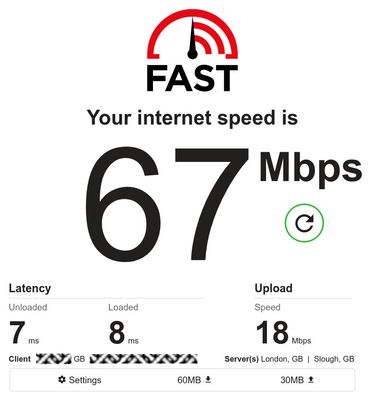

Small differences like that could be explained by the fact that many speed testers will dynamically choose what they think is your nearest and least loaded speed test server, before performing the test.
Therefore from test to test, you might be comparing different servers, that will be different distances from you, or be under different loading at different times of day, etc.  So not surprising to see a 2Mbps variation without knowing more information.
I rarely use speed testers, but instead check my modem's line stats, to see how it's performing.
Not having used the "Fast" speed test before, I just ran it to see if it showed which server it used, here it shows "Slough" -
