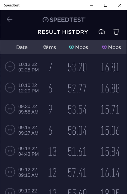

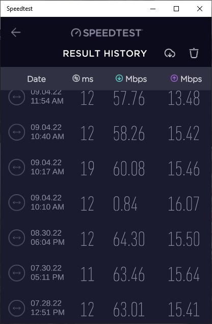

Hmmm.... @Gandalf
Something still doesn't feel quite right. I thought the speeds might return once it settled in, but it sadly hasn't. I'm not running super slow, but I'm not back where I was. And in actual fact the speed is getting slower.
Historically I was around 60-64 down. Not just for a short while, for years. The upload used to be 16-18, and that has slowed over the years to around 15 but I'm happy.
The US date format is confusing at first, but this is from the same desktop hard wired to the PN Hub from late July to early Sep:-
And this is what I'm getting now:
Around the 52/53 mark, lets call it around 10Mbps less.
Is there a settling in issue that hasn't gone to plan?
Grateful for anything you can think of.
Cheers,
Mark.
