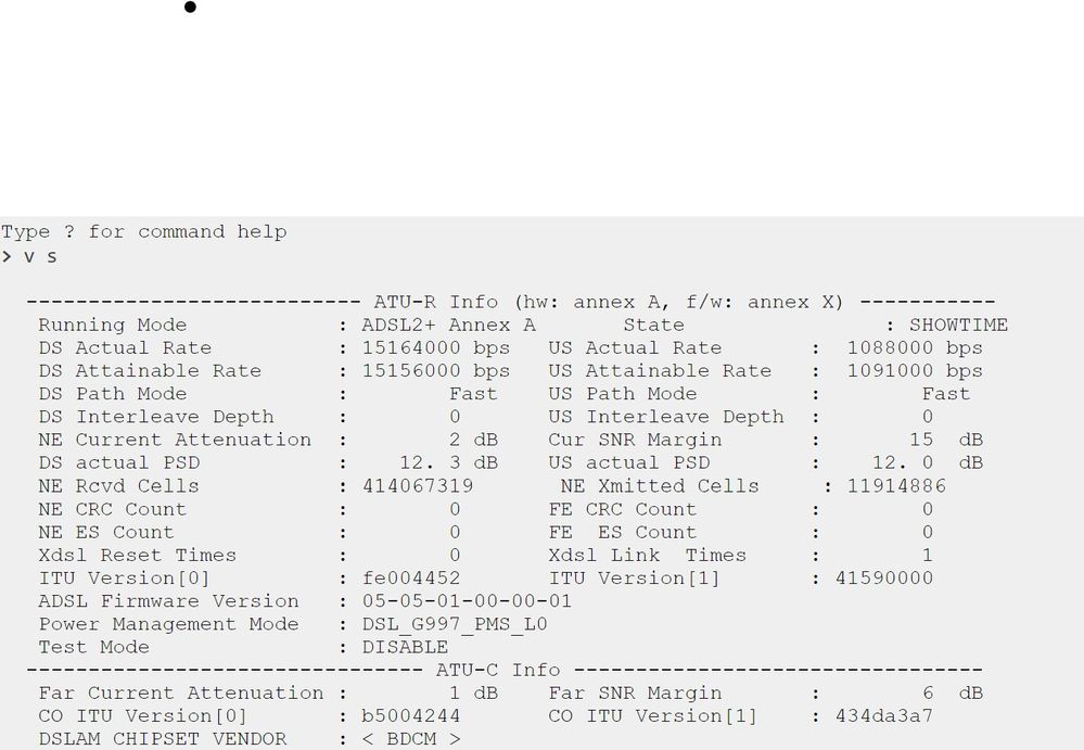

@weeally46  could you post a screenshot of your Vigor 130's console page showing the connection status ?
To get this info, login to your modem's web console, then in the top red banner on the right hand side, there are five buttons, click on the middle one that looks like a four channel mixing desk and shows as "Web Console" when you hover your mouse over it.  This should bring up a new window with a   >  prompt.  At the prompt, type  V  then space, then  S  and then hit 'Enter',  which should display a page with most of the useful connection details.

@weeally46  next time you are looking at your Vigor 130, check that it has the latest "3.8.5.1_BT" firmware installed,
available to download from here - https://www.draytek.co.uk/support/downloads/vigor-130

Re: SNR at 15db
@Anonymous It does have the latest firmware installed. It's nice to meet another Draytek user.
Re: SNR at 15db
Just to check your Vigor 130 configuration isn't fighting the DLM negotiation of SNR,
what does it say if you type  -
v snr
at the command prompt ?

Re: SNR at 15db
@Anonymous
