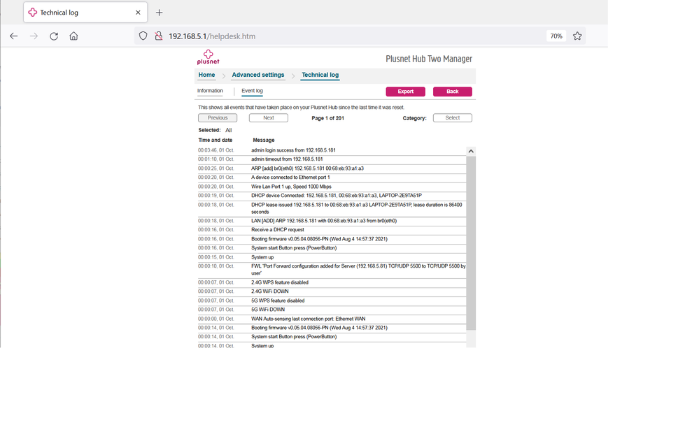

Navigate to Home>Advanced settings>Technical Log in the router, and you should see the option to 'export' towards the top RHS, as in the screenshot below:
Gah! Right in front of me! OK, here is the csv.

I can't see the expected DSL drops on there, although I note a couple of 'BOOT' entries which suggest, unless you are intentionally totally shutting the Hub down, that you have a dodgy Hub.
I'm not going to be sat in front of the laptop much this morning - maybe @Dan_the_Van  or @MisterW  may have some thoughts?
