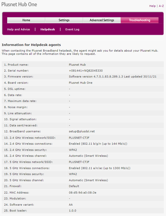

As it's a Hub One can you post a screen shot of the >Troubleshooting >Help Desk. Make sure you redact your broadband username.
The graph looks like a busy network
EDIT: are you using a wired target device?

Posts: 4,991
Thanks: 3,297
Re: Router sync speed is 40 down, 2 up
@matthews
Are you able to post a screen shot of the Hubs Helpdesk page? It will be a good indication to the state of your connection and data usage
To avoid confusion it looks like this

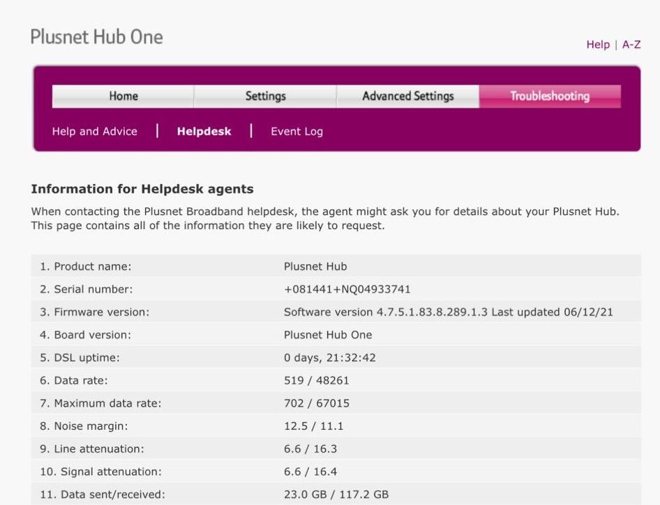

Just got them to send over a screenshot. Would appear that the sync speed is worse than it was the other day (which rules out my old profile theory).

21 minute  hour DSL uptime does not look good, I would suggest using the fault reporting bot, this would need to be performed on the mobile phone registered on the account
https://www.plus.net/help/report-a-problem/
EDIT: hour not minutes DSL UP time

@matthews I suspect they have a fault - the DSL uptime is low, and D/S SNR high.
