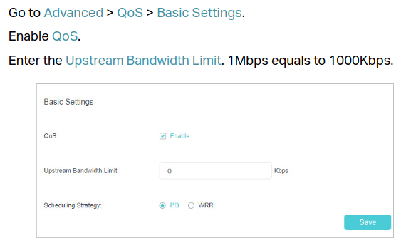

Now knowing you have a TP-Link VX1800v
while you are still on ADSL, your internet 'experience' is likely to be a bit clunky, and video prone to buffering, etc.
Try setting your router's upstream QoS, and it should make everything smoother, and less prone to stalling.
  • Login to the router's web console,
  • Navigate to the page shown below,
  • Enable QoS,
  • initially try setting the "Upstream Bandwidth Limit"  to say 950 Kbps
  • Set "Scheduling Strategy" to PQ
  • Then click [Save]
Screenshot 2025-08-04 at 17-51-36 1910013396_Archer VX1800v_UG_REV1.0.0.pdf.png
