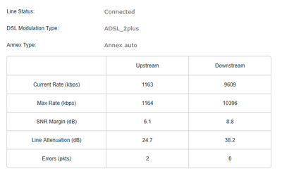

Can you post a screenshot of your modem's line stats ? - so we can get an idea of what your connection is doing.

As suggested…
- sight of the router full line stats would be useful (speeds, SNRM and attenuation)
- there is no earthly reason why a reset should not be done if the current stats warrant such
- there is a slim possibility that the business will not do this without doing a line test … I can envisage the possibility that someone thinks such a test cannot be run with there not being a Plusnet router on the line
@Windings - can you illuminate what might have happened here to deliver the strange disposition please?
Re: Request for line reset denied using own router
04-08-2025 3:38 PM
Ive attached two files, my old router before it died but the data was pretty constant, plus my new router.
As you will see the snr + attenuation are very similar.

Those stats look a little iffy to me. I'd guess that US target SNRM is 6dB whilst DS is 9dB ... but the snapshot figures are a bit a drift, suggesting there could be some environmental noise.
The disinclination to do a reset in the circumstances you describe is somewhat understandable, given IIUC a line reset is now an action which BTOR charges the ISP to perform. Performing a line reset which might deliver no benefit is not the appropriate use of resources.
Can you see from the router's log what is the connection profile? The Plusnet Hub Two reports the on-connection negotiated sync speed and SNRM (the target SNRM). Operational variance from that is indicative of environmental noise. If such is present, performing a line reset would be unwise until the source of the noise has been identified and eliminated.
Are there telephone extensions? If yes, how are they wired?
Take a look at routerstats (link below) and see if it will work with your router - either of them! I doubt that the router was the cause of your line instability issue. The US was marginally better with the old router, just about at the top of ADSL US capability. The DS is not too far off the mark either ... a little more, but not much might be obtainable over what looks like a 2.5km line.
Do you have a telephone handset? Have you checked the line for audible noise?

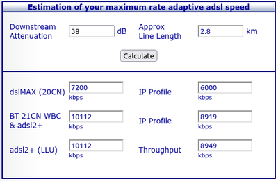

Comparing the TP-Link modems stats, with the expected speeds from the Kitz ADSL speed calculator ,
the line is performing as well as can be expected, and isn't 'banded' or needing a DLM reset.
@davebd It would still be worth following @Townman 's advice, on optimising the internal phone wiring, etc,
but trying to reduce the SNR, by minimising the environmental noise, on an estimated 2.8Km line length is likely unrealistic.
Given that ADSL is soon due to be withdrawn, upgrading to SoGEA would be a better plan than struggling with ADSL.
