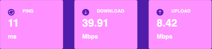

Sure @adamwalker here are the results:
Re: Reduced speeds over the years
30-10-2023 1:39 PM
Thanks @chevybeef
We wouldn't do a DLM reset at this point as your current line profile is "0.128M-80M Downstream, Retransmission Low - 0.128M-20M Upstream, Error Protection Off" which is quite good and your router stats don't show much difference between your current line rate and the max attainable rate.
Speeds on FTTC can drop over time due to various things such as crosstalk so it may be what you're getting now is the best you can get

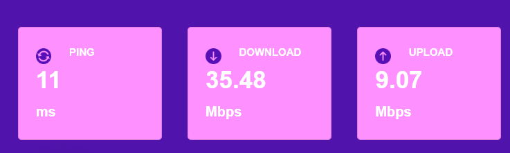

"Speeds on FTTC can drop over time due to various things such as crosstalk so it may be what you're getting now is the best you can get"
I've had a further drop in speed recently:
Would it be possible to do another line test to see if all is well?
