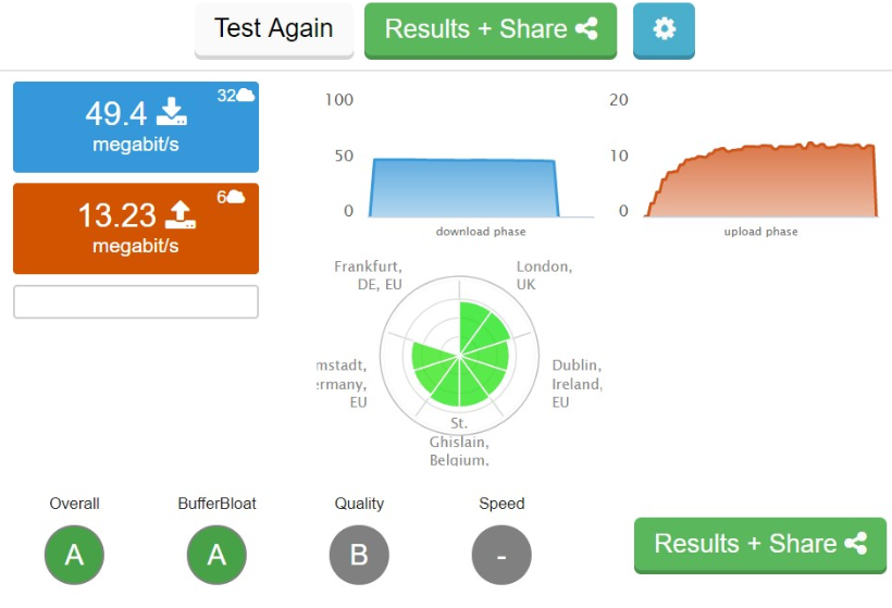

I have a screenshot of a speed test I did in early 2018. The raw numbers were even higher than this as the below numbers are with traffic shaping enabled in pfsense to reduce buffer bloat:
There has been a significant reduction in download speed and a large reduction in upload speed as seen in the current test results:

Re: Reduced speeds over the years
@chevybeef I can't see a current speed test?
Thanks John, I've updated the post. I assumed the "Observed Speeds" would suffice but this way is better.

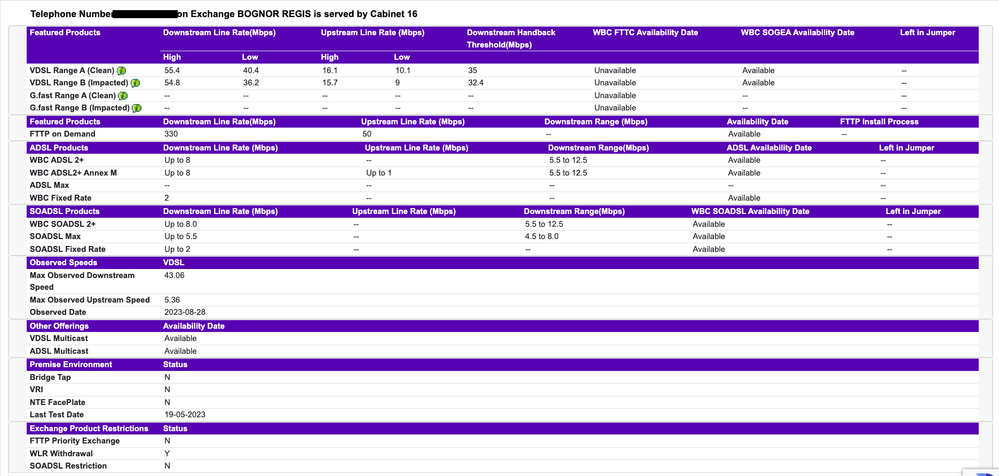

Thanks for that. The fault has been rectified by Openreach but the speed is roughly the same, around 40Mbps, which indicates to me that it's being capped at 40/10 by the DLM. Can I please have a DLM reset to remove the cap as my line is capable of much more as can be seen by this speed test from 2013:
Even my current product details mentions an estimated download speed of 66Mb so I don't see any reason why it should be capped:

Thanks for sending that over @chevybeef
I've just had a gander at the line and the profile is uncapped so there shouldn't be any issues with unbanding or anything like that. the speed is showing at 40.5 from our side which is above the Downstream Handback Threshold (Minimum guarenteed speed) so we technically don't see a fault in it, however, can you send pictures of the setup to see if we can help to try and improve the speed a little bit?
