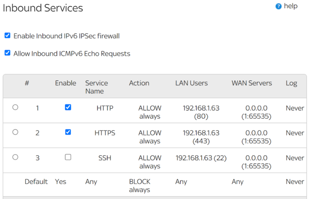

I took delivery of a "Plusnet Hub Two" router today and have set up port forwarding rules for a web server running on a RaspberryPi:
But this handy tool shows that these ports are closed to incoming requests from the internet: yougetsignal.com/tools/open-ports

The rules image you have posted look fine to me, when you attempt a connection you should see the inbound connection in the Hubs event log found ->Home -->Advanced settings --->Technical log ---->Event log and will be in this format
hh:mm:ss, dd mmm. FWL Port Forward Server(server IP Add) TCP nnn accepted a new connection from <client IP Add>
where <server IP Add> is the raspberry pi, TCP nnn will be 80 or 443, <client IP Add> will be the remote device IP Address.
The port checker should create a event log entry.

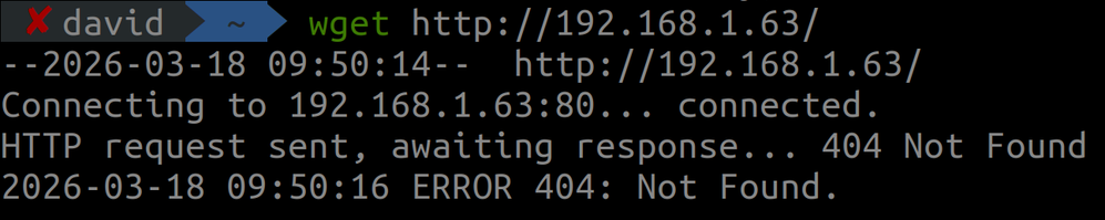

Here's a local test, performed from my PC (which has a wired connection to the router):
404 is the correct response from the Pi, so a successful local test.
