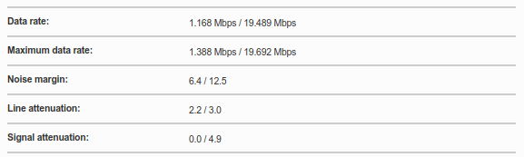

In that case, @stockfast , it slightly explains the speed (I don't recall the line length /speed correlation, although I would still expect better). However, the Attenuation figures on that Technical Log suggest very strongly that either they - or the engineer - are wrong.

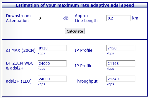

@jab1 wrote:
... I don't recall the line length /speed correlation, although I would still expect better ...
@jab1
Screenshot 2025-03-29 at 21-54-03 Plusnet Hub 2 ADSL no internet.pngScreenshot 2025-03-29 at 21-54-03 Plusnet Hub 2 ADSL no internet.png
Kitz says this -
Screenshot 2025-03-29 at 21-52-26 Kitz - Max speed calculator.pngScreenshot 2025-03-29 at 21-52-26 Kitz - Max speed calculator.png

Thanks, @outcast . I got involved on another forum before I had chance to check that, but you have proved what I thought - the line is performing as well as can be reasonably expected.
As I said earlier, I'll have a look at that error log tomorrow morning, but @stockfast , or his MIL, need to report a fault to PN.
The DSL uptime is horribly low.
