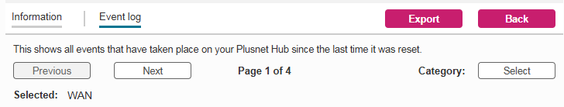

@Richchad
If you go to Event Log and select Category WAN from the drop down, this will provide the necessary information required with regards to DSL disconnections.

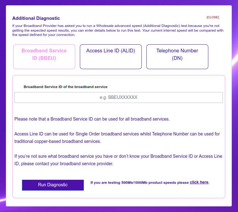

@Richchad wrote:
I notice I cannot get the BTwholesale speed checker to work, I assume this is because it was related to my home phone number?
You need to use your connection's "BBEU" number (which should be available somewhere in your Plusnet "Member Centre")
Posts: 20,438
Thanks: 9,273
Fixes: 585
Re: Part Fibre Option
Its in the Manage Account tab https://www.plus.net/member-centre/account
