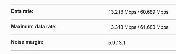

As you have a Hub2, can you post your Technical Log - obscuring your username? Navigate from the Home Screen to Advanced Settings > Technical Log > Information

Re: Part Fibre Option
@jab1  not sure why you wanted to see Technical Log but here it is..
@Richchad The only reason I asked for you Technical log was because of your speed report and your comment about the reduced MGS. From what I can see in it though, you don't have any major issues, although, given the reported connection stats, I'm surprised they have lowered your estimated speeds. Given those stats, I would have expected slightly higher download speeds though. Are you testing wired or wireless, and are you aware of any disconnections - you have only had 12 days of DSL connection?
@jab1 Thanks for taking a look at it, my PC connection is wired.

Power cuts are not what I was thinking about when I mentioned you shortish DSL uptime - rather xDSL disconnections, which are more common, and more likely to affect your speed/reliability.
They, apparently, now base your estimated speeds on what the BTW report has seen recently. If you want further help on this, is it possible to do a test using https://www.speedtest.net/ , and post the result, as well as the full report from BT Broadband - Address  , and the full exported error log from your Hub?
@Richchad wrote:
I am sure my existing FTTC account used to say up to 60Mb but the new offer states 49-55Mb
I wouldn't worry about it, as your modem is clearly connecting at 60.689 Mbps
