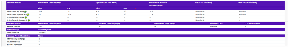

Thanks - this is what I get on the Additional Diagnostic.
Yes, I am connected directly to the Master Socket (ie. the Hub Two is plugged into it, if that is what you mean?) There is no extension wiring.

pvmb
Aspiring Champion
Posts: 1,897
Thanks: 408
Fixes: 15
Registered: ‎12-02-2014
Re: Painfully slow upload speed
Ha! That is what everybody gets on "Additional Diagnostics" these days.
