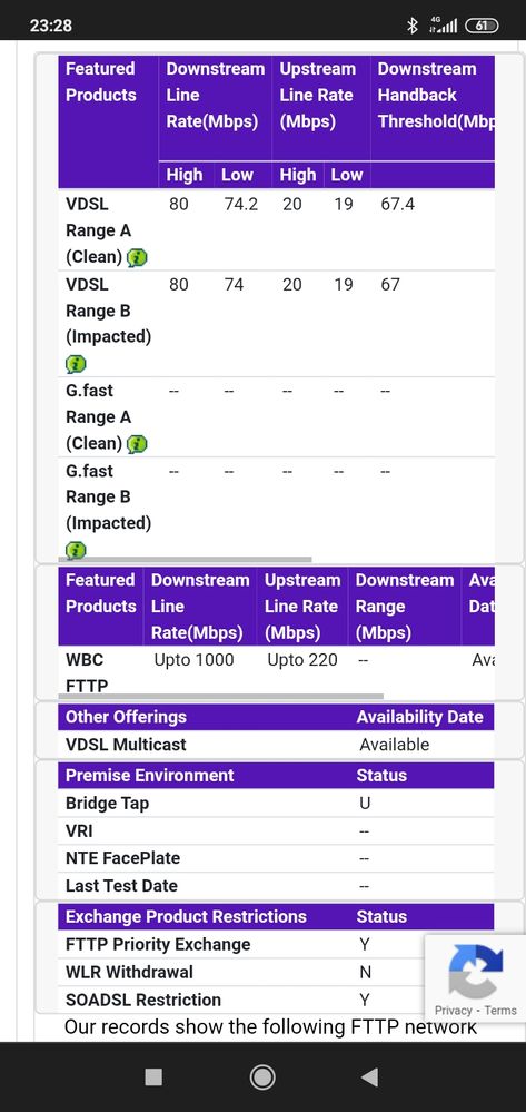

Ok it's been 2 days - still no fix. Had someone from PN call and said they would call back about sending an OR engi to visit. No call back. I did a broadband check and I'm pretty sure this doesn't look right. Where's the ADSL?Where's the ADSL?

@blackbolt  Do you have a ticket on your account, possibley waiting for you to say when you are free for an engineer visit?
What do you think is wrong with the BTW DSL checker pic you posted?

Guy said he would call back in 5mins to arrange OR visit. Don't know anything about a ticket. Shouldn't the above screenshot show ADSL info. I know I seen ADSL info there when I did it in the past.

Now it’s an FTTP priority exchange you will no longer see ADSL, and would not be able to order anything except an FTTP product.
