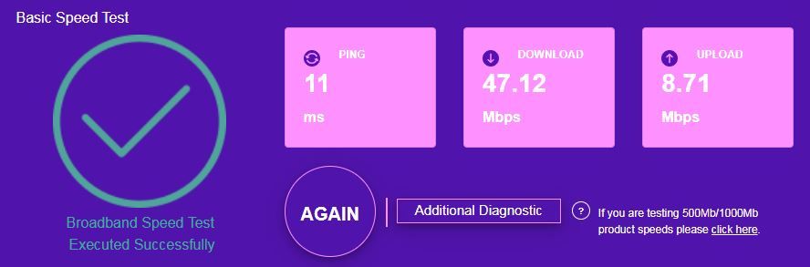

So, I got a text from 'Openreach' saying my service had been repaired and the 'speeds have improved'. However, the speeds are now just below 50Mbps when they used to be about 55Mbps. But they are above the 38Mbps that Plusnet have guaranteed, so I'm not sure I can complain.
No one contacted me so I don't think they will have read all of your kind advice and tech insight I'm afraid.
As I haven't had any further outages, I'm not sure what else I can do other than wait for another one to happen and go through all of this again.
Many thanks for all of your help.

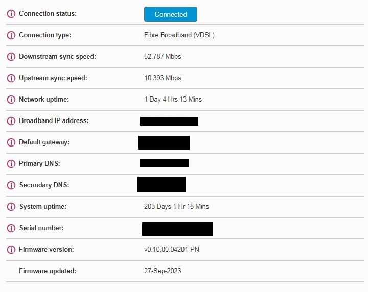

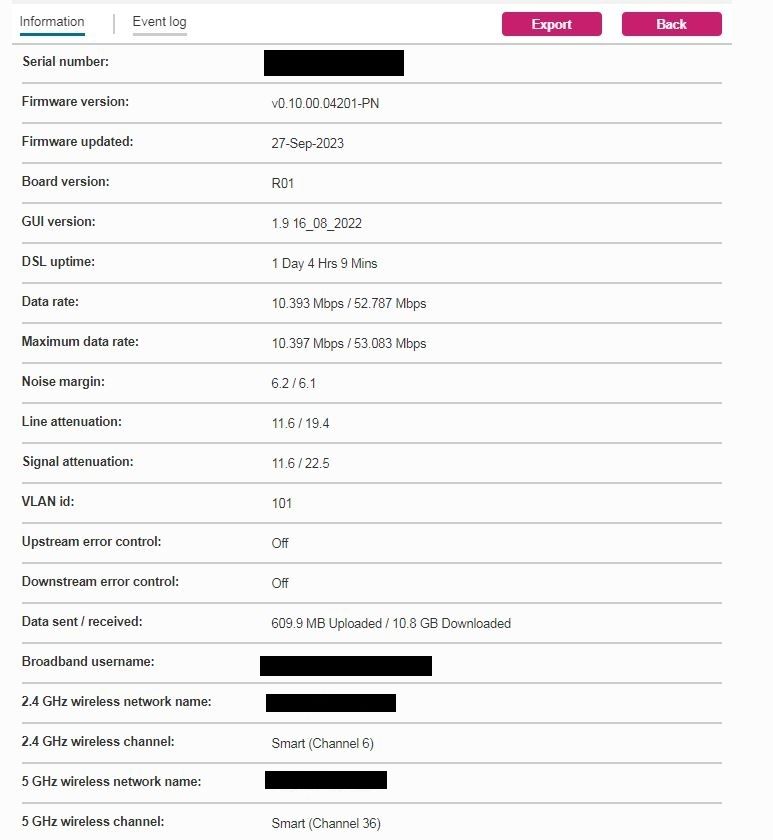

Can you please post the router stats - speed and SNRM values.
Re: Outages / slower speeds
05-11-2024 4:53 PM
05-11-2024 5:26 PM
Should the line remain stable over the next few weeks, you might see the DLM adjust the SNRM towards 3dB which will deliver a little more speed, but at the risk of instability.
This looks optimal for your line and I’d suggest is nothing to be concerned about. You might get a bit more raw speed but if that gives rise to an increase in error rates, then the usable speed will be lower due to retransmission over heads.
