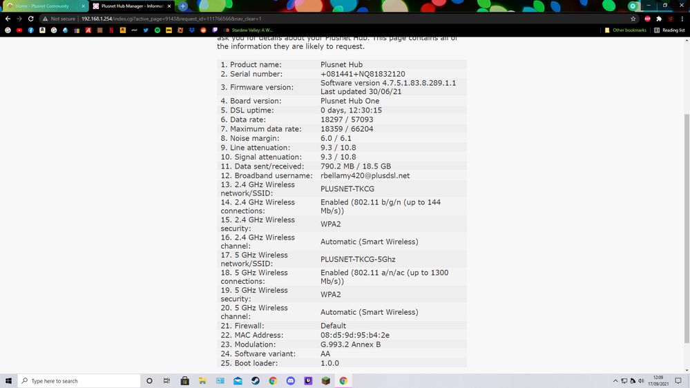

As an initial check, can you post a screenshot of the 'Help Desk' tab on your router?

Re: Not getting minimum speed.

OK , so one of my ideas is out of the window.
It would still be good to see your Help Desk information - might give us a clue.

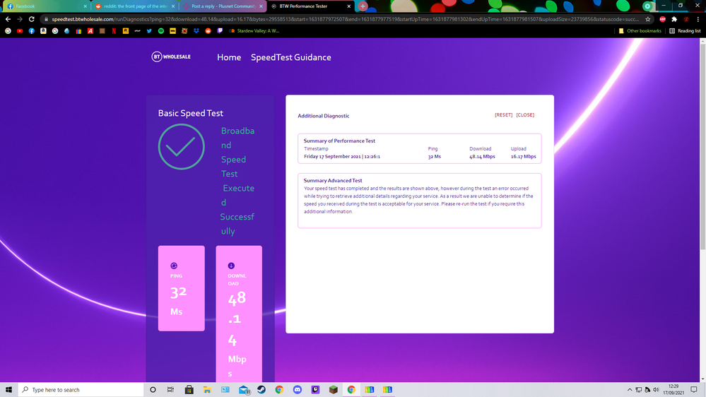

Can you please run this test BTW Performance Tester by both a wireless and wired connection, including the 'Advanced Diagnostics' - if it will complete, and post screenshots?

EthernetEthernetWifiWifi

Posts: 25,100
Thanks: 9,054
Fixes: 385
Thanks for those details - there is definitely something strange going off here, but it needs PN Help Team intervention. If you are leaving the router on all the time, with that stats as showing on your Help Desk screenshot, there appears to be problems somewhere (possibly) in the BT network, which will be affecting your speeds.

50 Mbps is about the maximum throughput speed for a line synching at 57 Mbps.
57 Mbps is reported as the data rate in message 4.
As the synch speed is below the Plusnet guranteed speed, you would need to follow the faults process at:
https://faults.plus.net

Thanks a lot for reaching out and I'm really sorry to hear that you're having problems with your line speed. I've just had a look into the line and can indeed see that it's syncing well below your Minimum Guaranteed Speed at the moment.
The order to upgrade your broadband did complete yesterday, but the profile on the line appears to be stuck. I'm made a quick note of the account on my end and will review it again on Sunday to see if it's budged. If not, I'll raise a DLM reset request to get this sorted.
