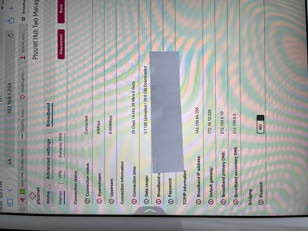

137EA60D-E0AB-439A-A39A-67C732054728.jpegFF51A3D0-7360-407D-AD97-D552597BDDCC.jpeg18852730-605E-4EA9-ABBC-286FEFAC28C5.jpeg

@MisterW @jab1
Hope these are what you needed and help. Thanks. They make no sense to me but an interpretation in simple terms would be good although not essential as I trust any conclusions you might come to.

@silver. Thanks for that. That confirms its been provisioned on 40/10 and is why your speed is limited to 40Mb
Curtis will have placed an order to correct it to 80/20 which should complete Monday ( next working day)  and your speeds improve to closer to the maximums shown in those screen shots
