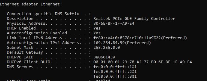

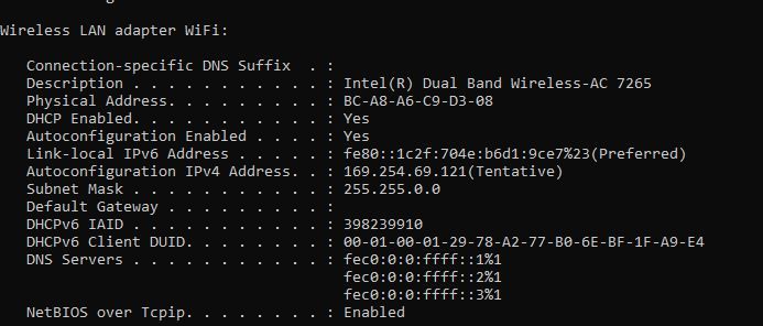

Ok, dont know if i've done this right, the top two are from the laptop plugged into the back of the rotuer,
and the bottom one is from my laptop which is accessing wifi from a wifi extender, keep in mind it wont connect to the router but will to the extender.

The Hub Two only has three LAN ports, you are not using the WAN port in error? The IP Address of the ethernet connection starts 169.254.... which is an address a network interface assumes if there is a network but no DHCP server.
