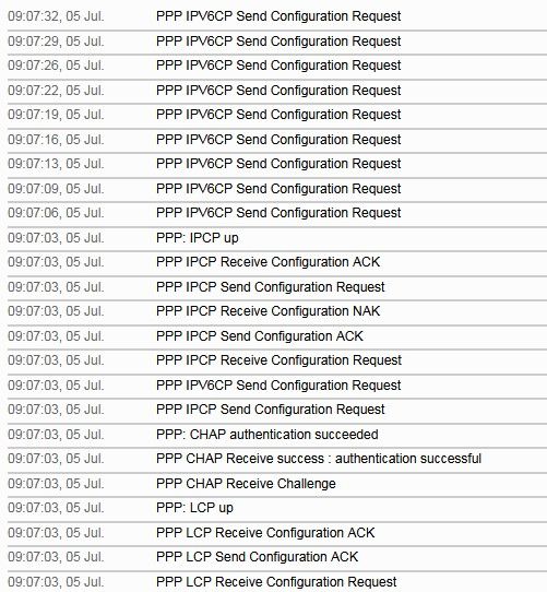

Screen capture of logfile (PPP filtered).
This was after the router and ONT were powered down overnight. The ONT was booted first. Once the two green lights were lit, the Hub2 was powered up.
I also thought IPV6 WAN was disabled on the Hub 2, but the 'PPP IPV6CP Send Configuration Request' still happen.
So far I've never seen a 'WAN connection WAN1_INTERNET_ETH disconnected.[ERROR_NO_CARRIER]' in my Hub2 router log (on a FTTP connection).
The other times I've seen that error is when the physical connection on a ISDN/FTTC got interrupted (testing by me - pulling the cable from the BT box or from the rear of the router). Also when I used to faff around with dial-up.
So it may be a problem with the connection between the router and the ONT (cable or the ports)?

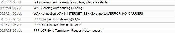

Just played around with the ethernet cable into the back of Hub2. Temporaily removed and reinserted.
Logfile
