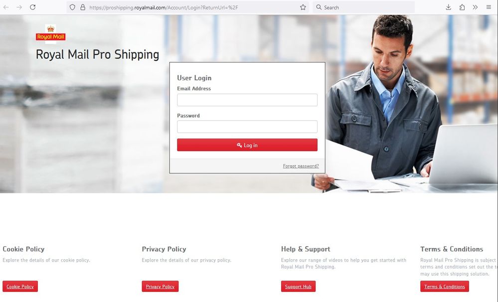

During this, I've been able to access the NS&I website *and* the RM website (screenshot attached).
