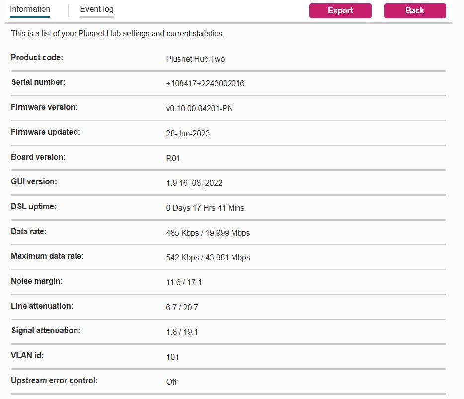

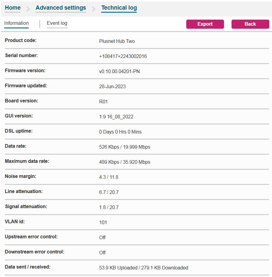

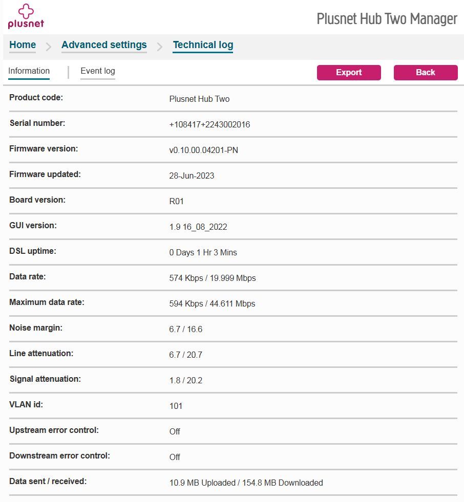

Ok ive tried my best with these screenshots, unfortunately I don't have a computer with a ethernet connection, but did put the laptop next to the router. The Advanced Diagnostics BT speed test didn't seem to want to work here though (it didnt when i tested my speed before), it tried it quite a few times.

That's fine, the screenshot from the Hub 2 says it all! You have a major problem with the performance of your line.
The downstream seems to be capped at 19.999Mb as indicated by the very high SNR margin, the upstream speed is appalling but since the SNR margin is only 6db it would indicate a line problem is affecting it.

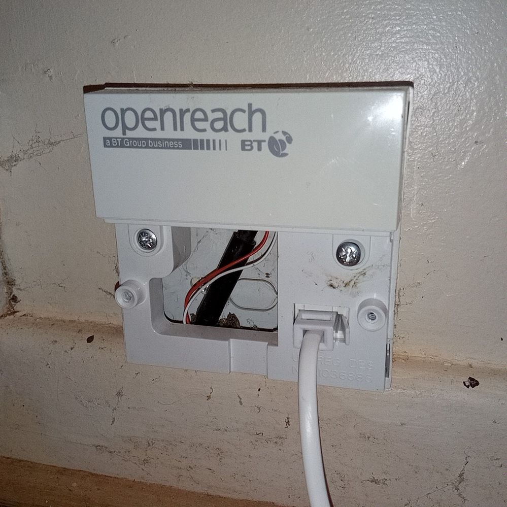

IMG_20230913_160234.jpgIt's connected directly to the mastersocket, there are no extensions. I did just take the faceplate off and plug it directly into the socket.   Here's what the router says with that setup

Ok, so basically no improvement, that eliminates any internal wiring as a cause, you have a fault on the line which is causing the low speeds. The downstream is way below the handback threshold (MGALS) and , as I said earlier , the upstream is diabolical!
You need to report a fault, which should get an Openreach engineer appointment to investigate.
In the first instance ( assuming you have a mobile ) then use the Troubleshoot by text facilility here https://www.plus.net/help/report-a-problem/broadband/

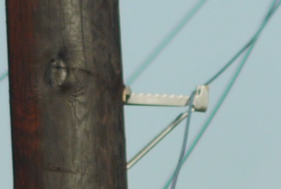

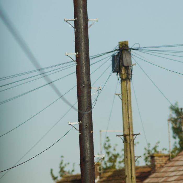

OK, I don't know if this is relevant, BUT, CityFibre have been installing fibre across the town and recently they installed a tall telephone pole a few houses down, I noticed that the line from my house to the old pole behind it is draped across one of the rungs on the new pole.  Could they have damaged the line when installing the new pole?  I've attached a few pictures.

Your line looks a bit slack, so I would question what else have they done to it ? All the others still look correct.
If that was about when the speed started to drop, then its probably not coincidence!
Start by reporting a fault, and an Openreach engineer should spot that cable and check it out.
