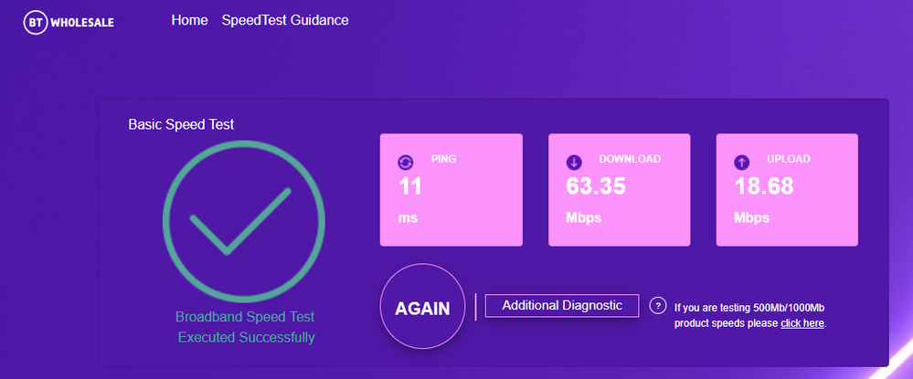

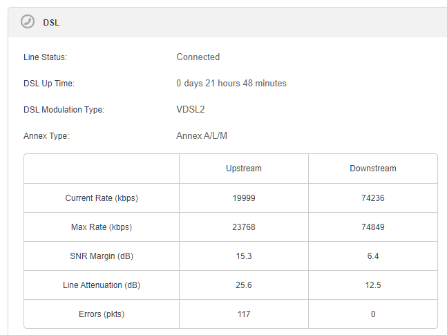

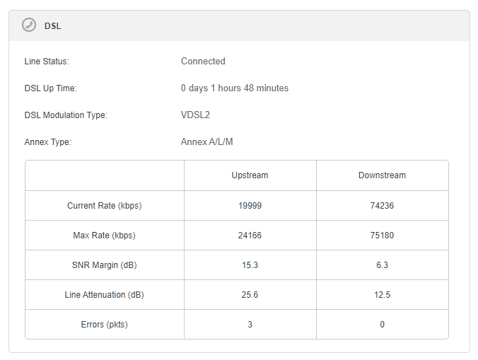

They replaced the line and masterbox with a new masterbox, so now the line comes in and goes straight to the new box and there isn't any internal wiring at all. Which is nice.
However we have a really good sync it still tests out at around 63. Any thoughts?
Thanks!

There does still seem to be some banding or a lower ip profile in place. The maximum I am seeing is around 63mbs even though I am synced higher. Does something else need to happen to get that lifted?
Thanks,
R

Hi there, it looks like DLM has done it's job overnight but our systems haven't caught up yet so I've updated the profile on your account to 74.2mbps for you.

Thanks Adam. How long before it takes effect, do I need to reconnect or anything? Thanks for all the help, much appreciated.
R
adamwalker
Posts: 16,922
Thanks: 869
Fixes: 223
Registered: ‎27-04-2007
Re: Moved, Terrible Wiring, Terrible Connection rate
No worries! there's nothing you should need to do and it should take effect straight away.
 Adam Walker
RHines
Posts: 76
Thanks: 29
Fixes: 3
Registered: ‎01-10-2017
 Weird, it still seems to be locked at 63.
