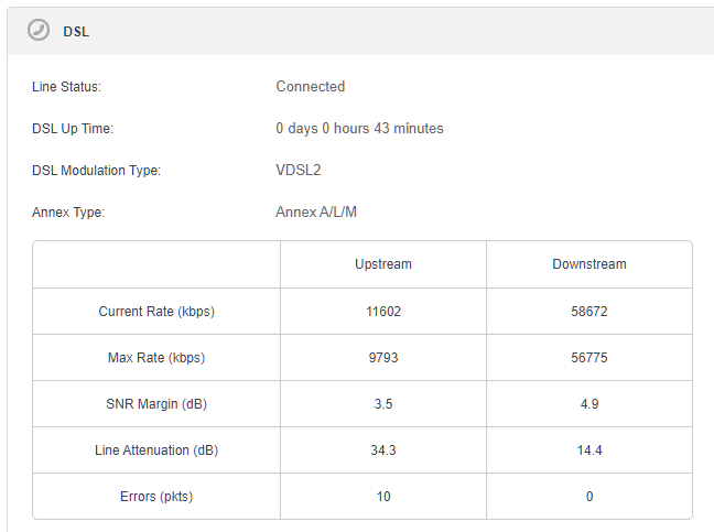

Getting slower and the SNR is dropping through the floor.
2022-04-19 16_37_31-Archer VR400 and 4 more pages - Personal - Microsoft​ Edge.png

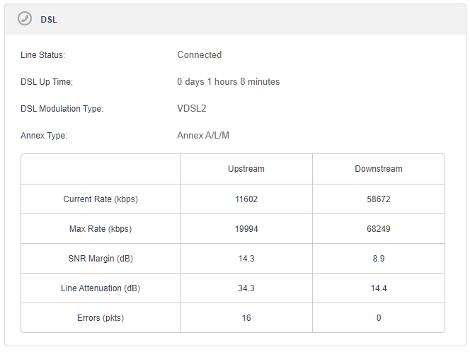

Re: Moved, Terrible Wiring, Terrible Connection rate
and now it's going all the way back up..someone working in the area maybe?
2022-04-19 17_01_13-Archer VR400 and 6 more pages - Personal - Microsoft​ Edge.png
