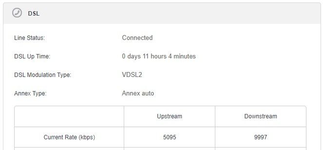

Not for the first time the DLM at the exchange seems hell bent on dropping the sync rate on the line almost every night.
But though the line is fine (I constantly monitor packet loss) and is usually a whopping 24mbps.
Currently our line is as below .... (DSL up time is the result of the DLM re-syncing the line AGAIN last night)

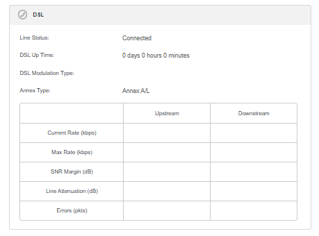

Thanks for that. Irrespective of a 'bad' line, you are way below the 'handback threshold', so I would report a fault using https://www.plus.net/help/report-a-problem/ . As I'm not familiar with your current router, is it possible to display similar information from it to the below (screenshot from a Hub2 router)?
zenza
Posts: 17
Thanks: 3
Registered: ‎23-07-2024
Re: Minimum Guaranteed Speed and DLM reset
The best equivalent..

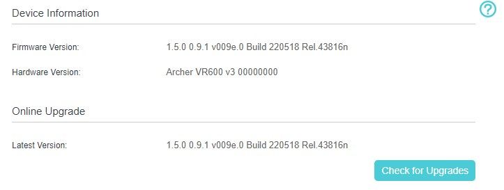

OK, I understand and sympathise with your frustration. Bearing in mind the lousy service you have, would you be prepared to replace the current router with the PN Hub2 for a few days, as that gives access to a wealth of useful information - if you still have one?
Posts: 4,284
Thanks: 3,262
@zenza
The status page from Advanced Settings is what required
Fair enough - all I saw on the example was firmware info - thought it was a strange request to be fair.
Posts: 17,638
Thanks: 8,968
Fixes: 383
Thanks for that @zenza . It proves what I said - you are way below your potential speed and below the Hand-back Threshold, so Openreach need to pull their finger out and make some effort to improve the situation. If I were you, I would be raising Cain and involving my MP/contacting the Openreach CEO.
