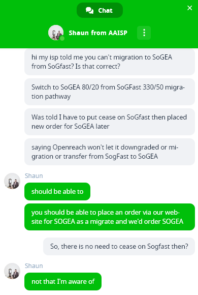

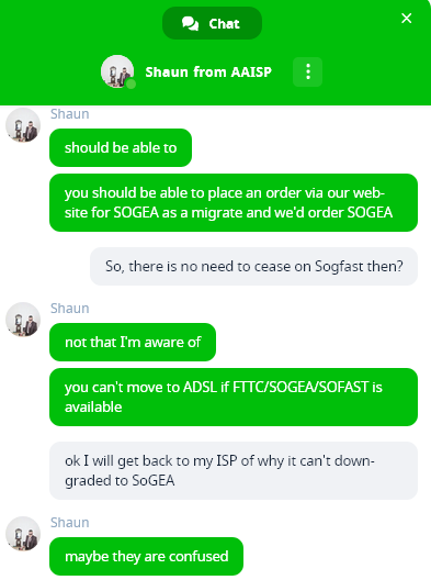

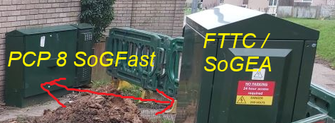

Here is Screenshot
I don't get it at all.
Why can't Openreach disconnected Sogfast from PCP8 and reconnect SoGEA on the FTTC cabinet on the same day of migration switch? @Gandalf @MatthewWheeler

AAISP say this wrong!
It's can migration to SOGea from Sogfast!
