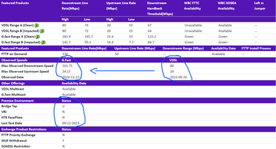

I think Openreach engineer forget to marked it SOGFAST 330/50 active at my property on the master socket as the BTw Checker seem to say there is no SoGfast at my property. How strange. I was on SOGEA 80/20 last day on 26th September 2023 before moving me onto SOGFAST 160/30 on the 26th September 2023 before upgraded me to SOGFAST 330/50 on the 27th November 2023 and still on it. As you can see Observed speeds of 261/34 on 23rd November 2024 stamped.

I suspect you'll need to raise this to your ISP @goldenfibre as the only thing we can see on the address is a SOGEA line.
They'll most likely need to raise this to Openreach to correct the records

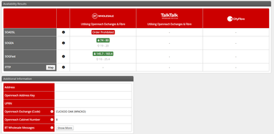

Plusnet are mistaken, the checkers shows your property as having SoGFast available, see attached.
Cheers,
Keith

I suspect that there are semantic confusions here.
Your own statement above seems to suggest that BT OR systems might not have your property marked as having an ACTIVE SoGFast service.
PN's statement I read as supporting that perception in that the records do not state that there is SoGFast at your property.
Your current supplier simply advises that it is available at your property, not is not the same as confirming that the BT records state that the service at the property is SoGFast.

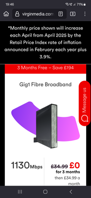

I can see Virgin Media offer 1130Mbps down and 104Mbps up on a black friday deal with no setup fee and no install charge with free hub plus free for first 3 months! £34.99 a month for 18 months contract but I don't like this 3.9% plus RPI (so it will be twice rise closer to around £41.99 a month! That's PUT ME OFF!
I think all 18 months contract should be FIXED LOCKED PRICE! Fed up with this country daylight robbery! And ofcom are useless because they can't stop mid-contract price rise!
Re: Migration Pathway
28-11-2024 3:23 PM
I must admit , I thought Ofcom had banned x% plus CPI increases but apparently its not mandatory until Jan 25. Most other ISPs have already changed to pounds & pence increases, seems Virgin are waiting until the last possible date!
