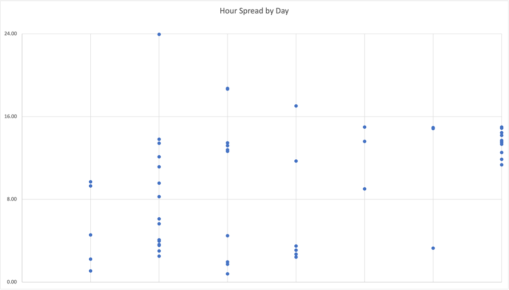

Nothing common about the drop days or times (Time vertical / DOW Mon-Sun horizontal):

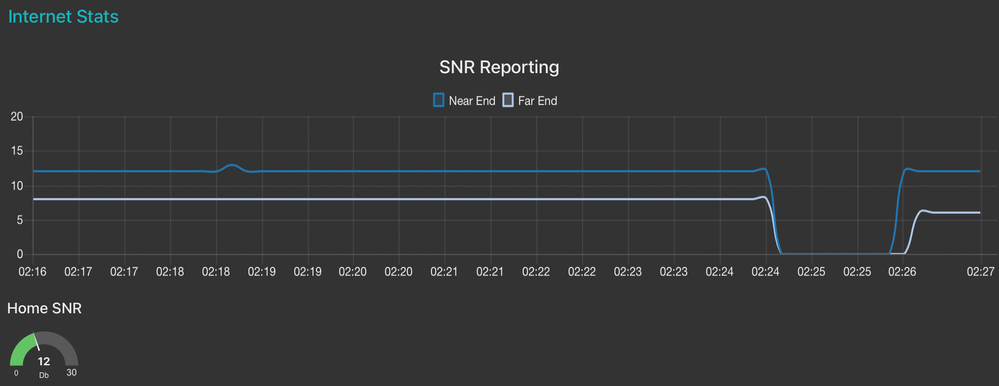

I did manage to get a SNR graph at the time it dropped and it does not show any significant change on the SNR before the drop:
but it seems to be changing between 12 dB and 13dB at my end before it dropped.

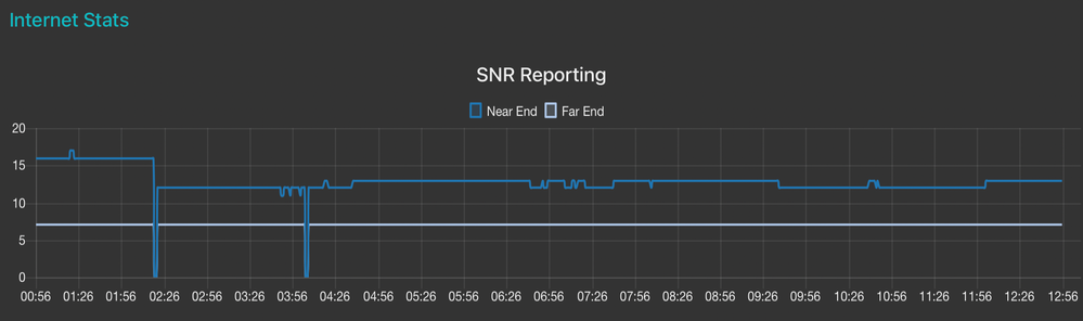

No significant changes in SNR reported by the router with 10 second samples:
Any ideas?

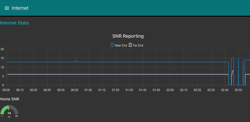

Well this morning was painful - just catching up with MasterChief and they just announced the first leaver and then this happened:
Not seen it do that since I got the graphing running - wonder if this was the exchange as the SNR went up but the speed dropped!
