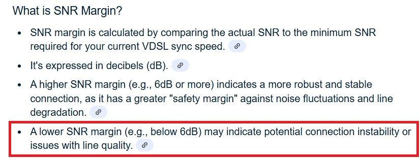

It's not SNR, it's SNR margin, and generally speaking its level controls your connection speed as a trade-off against stability.
If you want a higher SNR margin then you'll get a lower speed, but better stability.
Perhaps you'd like to research it for yourself as you seem to think higher is better;
SNR margin VDSL

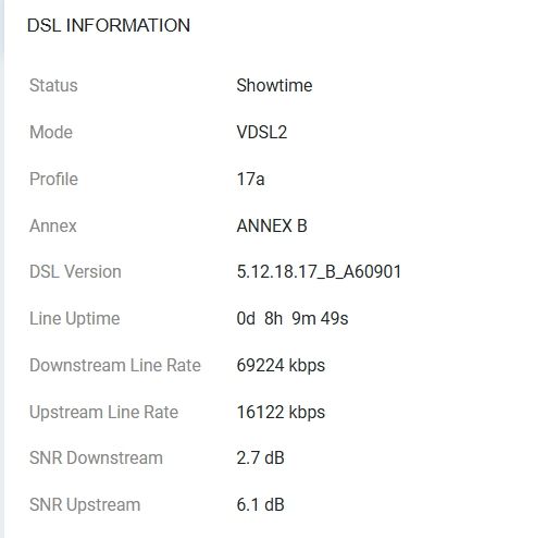

If you look at my first post, I was getting consitent speeds of about 73Mbps (and I have been getting that for years), In March this dropped to about 64Mbps, and a couple of weeks ago, my speeds dropped again to 54Mbps - DLM reset and Im getting 56-57Mbps
I mention SNR Margins, because it seems to be 'artifically' increasing my speeds to 56Mbps, Id hate to see what my speeds where when it was normally at 6dB.
So, the issue is.... Why has my speeds dropped.  What happened in March for it do so, and then again a couple of weeks ago.  To resolve an issue, one must investigate and determine the cause.

@RobPN
From your link:
Hence the reason I keep referring to it.

The question not asked and investigated is why is the DS interleaved (and quite deeply) whereas the US is on fast path?
As for the AI reference to low SNRM being associated with connection instability, the point is being misconstrued and no context is being given.  There is nothing wrong with a 3dB MARGIN** is there is no environmental noise.
In an environment with RFI noise (REIN) in order to sustain a stable connection, it must have a MARGIN which is greater than the intermittent electrical noise.  In that context the AI summary is valid.
The presence of interleaving on the DS suggests that a high level of error management is being applied ... the question is why?  Typically the answer is found in the user's environment, not in the service provided.  Electrical equipment can (especially cheap PSUs) go marginal without actually failing.  It might be prudent to look into REIN.

I also took note that the downstream is on Interleaved.  However, as far as I am aware, this has been like that for years.  So unfortunately, in my opinion this is not the change that caused my speeds to drop.  Nothing internally in my flat has changed in the last few months, no new electronic equipment, no new leads and certainly nothing changed in the area where the modem is located.
Other than a short blip a few years ago, where there was noise on the line - my down speeds have been maintained at around 70Mbps (there or there-abouts), and upload speeds about 18.5Mbps.
