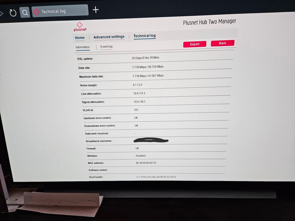

If you have a mesh system, then then Hub2 should be in modem mode anyway. From the data in that screenshot, cab 25 is some distance away, so you will never get great speeds, but as we have said, there is a 'training period' where the equipment in the cab attempts to find the best speed/stability balance. If your data rate does not (slightly) improve, or gets lower, in the next 10 days or so, come back and say so.

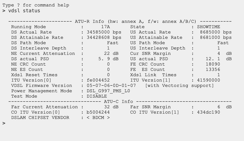

A few days ago I bought a vigor130 on ebay, second hand quite cheap, just to experiment what would happen. So far the upload has gone up to 8 or even 10mbps but I hadnt seen any benefits in the download (if anything it might had made it worse), and the latency is even lower, which is great.
Vigor130 gives this...
| VDSL2 Information (VDSL2 Firmware Version: 576D17_A/B/C ) |
| Profile | State | UP Speed | Down Speed | SNR Upstream | SNR Downstream |
| 17A | SHOWTIME | 8685 (Kbps) | 34585 (Kbps) | 6 (dB) | 5 (dB) |
Is there a way way to ask plusnet to rerun the "training" now that I have this modem?

From the vigor cooler stats...
vdsl status
Re: Just joined FTTC, speed lower than expected.
06-01-2025 12:28 PM
@Harland84 As said 6 months ago, you have a longish 'final mile of copper, so you are never going to get supersonic speeds until you get Full Fibre (FTTP). However, your current stats look about correct.
