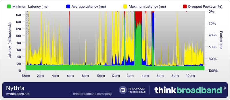

I'm now generally skating just above the minimum download speed, but my upload speeds are around 4 megabits per second The modem is syncing at just over 3DB SNR in both directions. This was not the case originally, and I can see that the overhead line is rubbing across a neighbour's roof, which presumably is causing it to become damaged.
It is also becoming quite unstable with multiple resyncs and very high pings in use - see recent Thinkbroadband plots below from last week. Is this enough to raise a ticket?

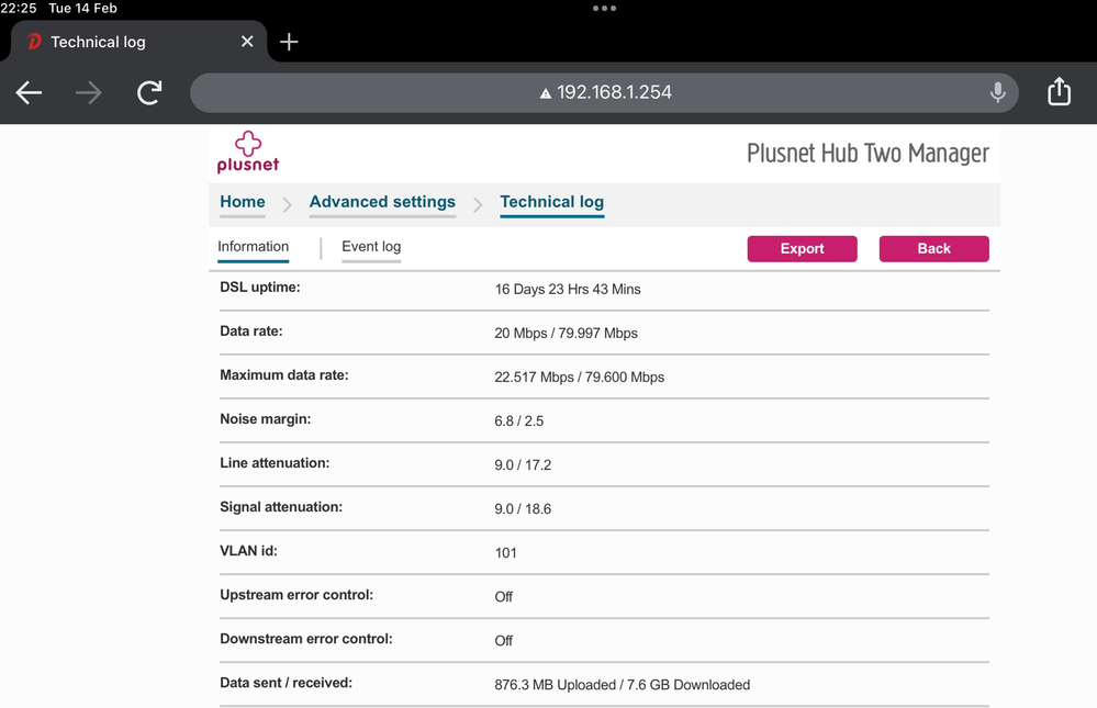

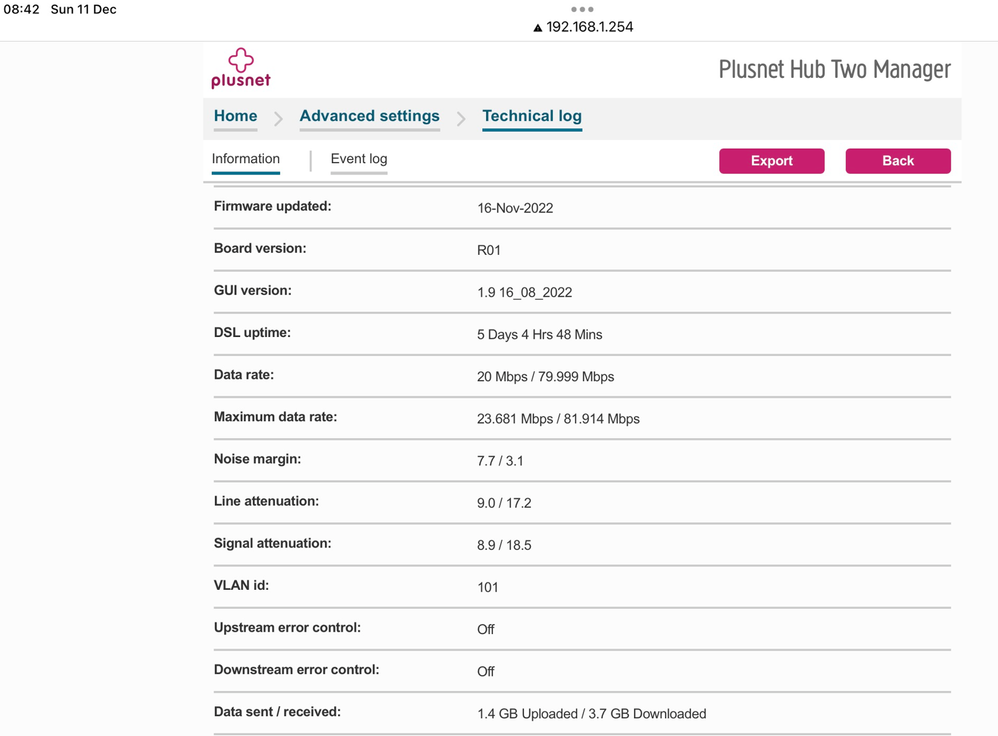

I've dug out the technical logs from when the line was first set up - one in Dec 22 and another in Feb 23. I'd forgotten just how good it wasDecember 22December 22Feb 23Feb 23.  I can't run a current one at the moment, but it is very significantly worse when I looked a few days ago.
