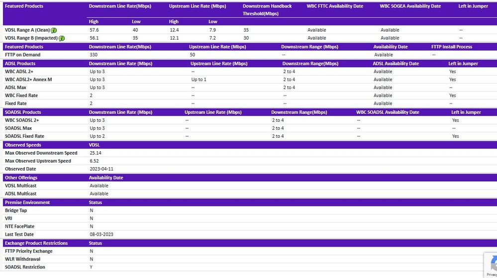

Apologies for not getting back sooner I was bogged down with other IT matters! @jab1 see below results of the test. My speeds appear to be random using the BT test, anything from 0.36mbps to 22 mbps. I can't seem to use the diagnostic part of the test, it says...
"Summary Advanced Test
Your speed test has completed and the results are shown above, however during the test an error occurred while trying to retrieve additional details regarding your service. As a result we are unable to determine if the speed you received during the test is acceptable for your service. Please re-run the test if you require this additional information."
I only know my telephone number though.

@AWB70 Can't remember if I asked - are you on Unlimited Fibre or 'Unlimited Fibre Extra'? Either way, you are under the handback threshold, so my suggestion is to report a Broadband fault via  https://www.plus.net/help/report-a-problem/broadband/ and let us know the result. If they say there is no issue, they are not telling the truth.
The advanced diagnostic on the BTw site appears to be broken - again - as you are the second or third person to have reported this today. No matter, the screenshot above tells us all we need to know.

Thanks John, I'm on unlimited fibre, are you saying there is information in that screenshot that suggests there is a fault, if so what in particular?

OK, so the 40/10 product then. Given that, with the line/signal attenuation figures on your Help desk pages, I would have expected something closer to the low to mid 30Mb/s range for download and maybe a bit more than you are seeing for upload,
Your wildly fluctuating speeds, and the very low uptime in your Help Desk shot, strongly suggest you are having constant xDSL drops. At one time, the Help Team would post the RADIUS logs to confirm/disprove this, but they seem strangely reluctant to do this these days.
